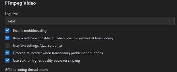

The cause for the audio delay will be from Mencoder as it was being used due to the subtitle format.
Switching from FFmpeg to MEncoder to transcode subtitles because the user setting is enabled.
This should not be an issue for FFmpeg these days so turning off "defer to Mencoder for problematic subtitles" will help.
Screenshot 2025-04-03 203358.png (14.39 KiB) Viewed 45013 times
