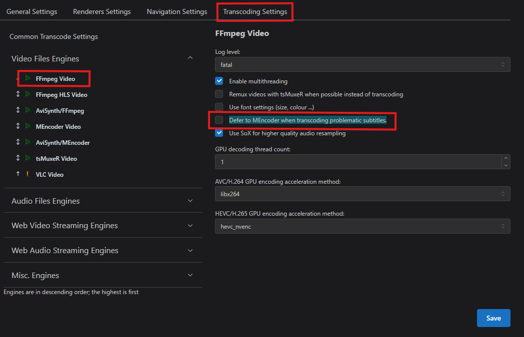

When it is transcoding it should be using FFmpeg but there is one setting that will defer to Mencoder when there are certain types of subtitles.
Switching from FFmpeg to MEncoder to transcode subtitles because the user setting is enabled.
I think this was because FFmpeg did not handle some of them correctly in the past but should no longer be an issue.
Mencoder is usually the suspect if they are out of sync too and may be causing the black screen if it works normally when selecting FFmpeg in the Transcoding folder.
Try turning off "Defer to MEncoder when transcoding problematic subtitles." in FFmpeg settings.
Screenshot 2025-06-04 032732.png (55.89 KiB) Viewed 134444 times
I think the way this setting worked changed or got enabled by default when it used to be off between those versions.

I made the recommended changes, putting the test renderer file in the location specified. The TV does not have an option to "Enable/Disable subs". It shows whatever UMS sends it.
I also Unchecked the option to "Defer to MEncoder..."
