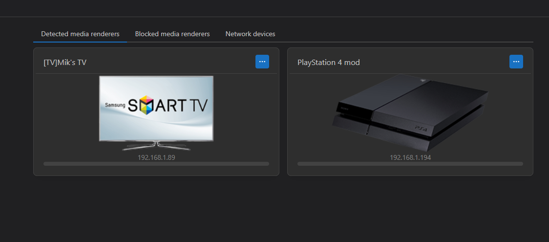

I don’t understand something in the settings old ones it shows my media folders and I installed the VLC program on my Fire Stick it shows the program but it doesn’t show any video when I select my laptop and I can’t tell if the Universal Media Server is detecting my Fire Stick
Re: I have a question about Setup
If you look on the web interface you can see what is detected. You need to set up the shares here in the shared contend section.
Screenshot 2025-06-26 025113.png (92.74 KiB) Viewed 117413 times
If nothing is showing I will need to see logs to find the problem. See the section in red above.
