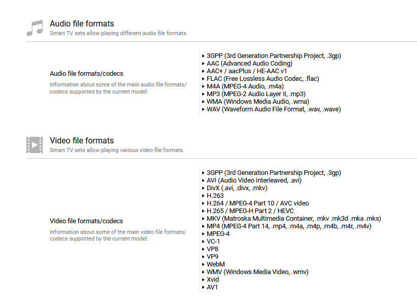

I did find a manual for the U7N here which gives more info on what is supported but not had time to put this in a conf yet, but I have made a start. I'll see if I can get it done tomorrow.

I found a better source for that manual here in PDF format but not sure if it is actually for this TV as the model number on the first page is ES-A23031Q, but I can't find any info about this model number so it may just be the E-manual for all Hisense TVs.
Since I found no other info I based the conf on this so it may not be entirely correct. Any other changes you will have to do yourself.
I had to guess on what transcoding settings will work so you will have to experiment to find what works, I have left some notes on what to try and change if you do need to transcode. I don't even know if subtitles are supported so I added the most common ones just in case and should at least prevent unnecessary transcoding of video with subs.
