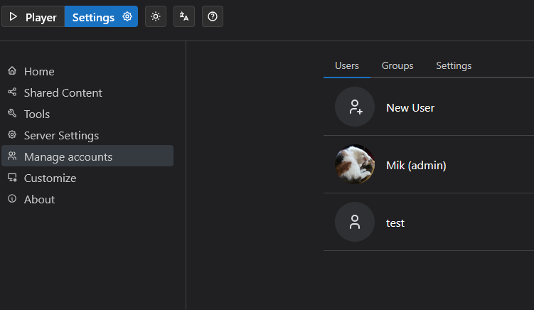

In the WebUI when you log in as admin you can set them up "Manage accounts"

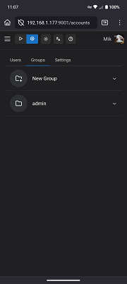

You can make new users and groups and assign a user to a group.

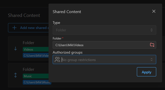

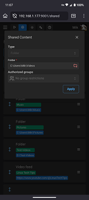

Then in "shared content" you can edit the folders to assign a group that can access it

I had not tried this myself on mobile before but checking now it works well and easy to do.

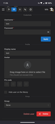

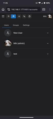

The mobile site works just fine even on my cheap crappy android phone using Firefox and Chrome, I did not have to show 'desktop site'
What phone and browser are you using?
Having said that I tried making a new user and group but on the user settings when I select the group dropdown box the page jumps up and the box does not work.
This works fine on the desktop so this is definitely a problem. I will report this.
