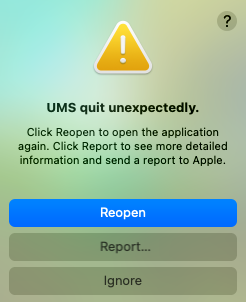

What exactly happens when it crashes? Is there an error message? Could you post a screenshot.

Well that didn't help:
Screenshot 2025-12-02 at 19.37.29.png (59.26 KiB) Viewed 120461 times

RE the last crash with the screen shot: I had started the scan manually, so still related.

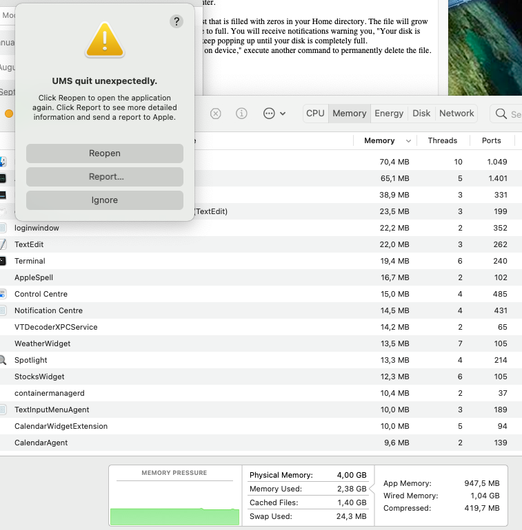

Screenshot 2025-12-03 at 15.11.18.png (180.71 KiB) Viewed 120392 times
I cleared the cache using dd if=/dev/zero bs=100m of=~/Test
When I started the scan the cache was practically empty.
I will now try scanning incrementally.
Re: MacOS crash
I know very little about Macs but I think it could be it could be running out of resources like memory.
I have seen in logs from Linux that it does show errors when memory is low so if this is what is happening I don't know why it would not show here too.
That error message it shows is not very helpful.
Does it give more information when clicking on report or does this just send it straight to Apple?
