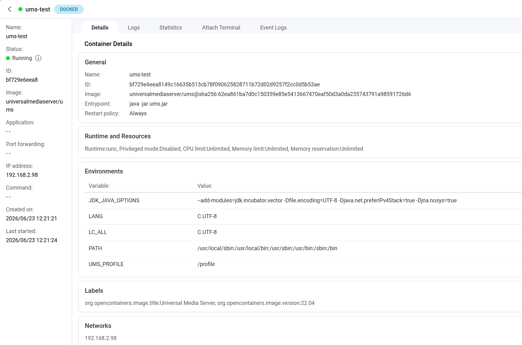

That's it, at least for the french title.
Adding LANG=C.UTF-8 and LC_ALL=C.UTF-8 as enviironment variables in the create procedure to my Nas-Container-Build was all to do.
Now I will check the complete musicbox.
Thanks a lot for you support.
- Screenshot TS451 Container.png (160.01 KiB) Viewed 9024 times
