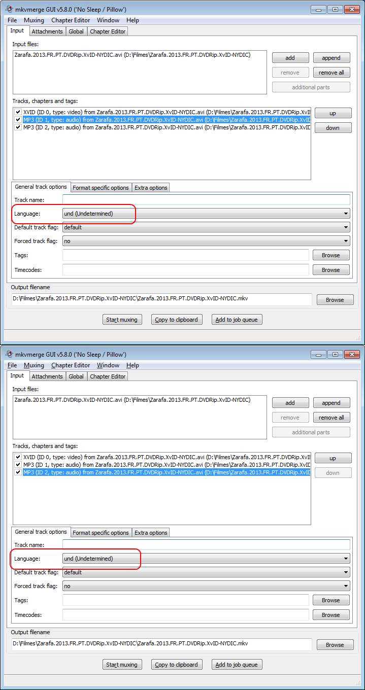

use UMS to watch movies in a LG SMartTV 42LA620S.
I have a dual audio movie and if I inspect the file, there are 2 audio tracks but with no flags, I mean it has "und" in Language (see attachment pls)
Is it possible to set Track id# instead of 3 letter language code, in Audio Language Priority?
Or something like und1, und2 ...
How to do in this situation?
Or do I have to set flags in mp3 part of the file ?
Thanks.

In that case the only way is to go to the TRANSCODE folder and choose the audio you want to play. Is impossible to distinguish between two undefined languages. This is a problem of people who code the video to set everything properly.
