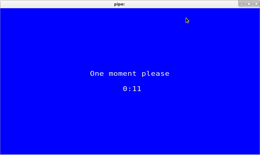

 python vmsg.py -m "One moment please\n\n" -t 20 -x -b blue | ffplay -
which (with any luck :)) should generate:
AudioMan

the last argument 'delay:buffer', and should give you a 20 second delay in UMS
Thanks very much! That worked brilliantly!

Thanks for the feedback!
I made a change in the above post to the script so that it follows redirects correctly which feedproxy.google.com feeds were having problems with.
