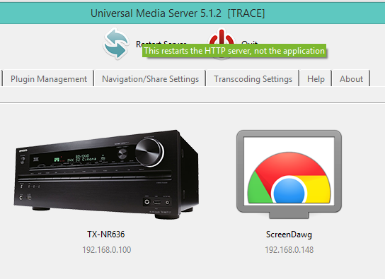

The PS3 not seeing the UMS.
The UMS not seeing PS3
i attached a screenshot of status tab and as to whats appearing.
- UMS version 5.1.2
- Windows 8.1
- PS3 confirmed as to IP address and net work connectivity.
-The UMS picks up my onkyo receiver, Chrome cast, and Android media player called XIOS DS media player
- i uninstalled and reinstalled UMS wtih no success.
Any help you can provide would be greatly appreciated. thanks
Image of the UMS status tab

any ideas as to why ps3 not appearing in UMS

The IP address associated with the PS3 is 192.168.0.130 and the laptop is 192.168.0.139.
also review my original post as it has shows a screenshot of there devices the ums picks up without an issue.
