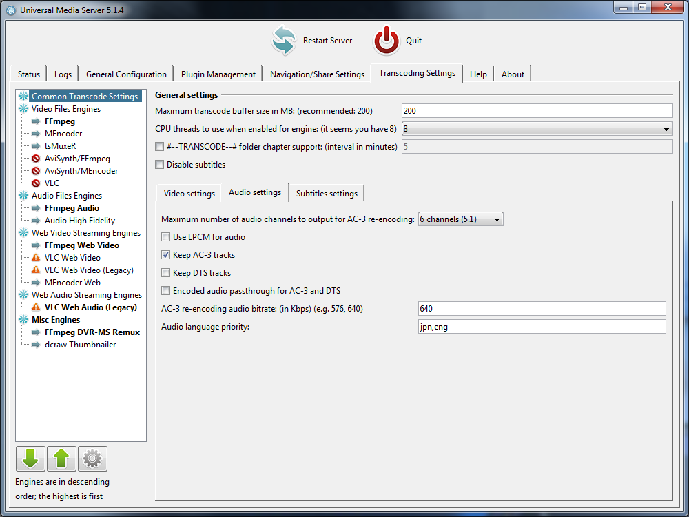

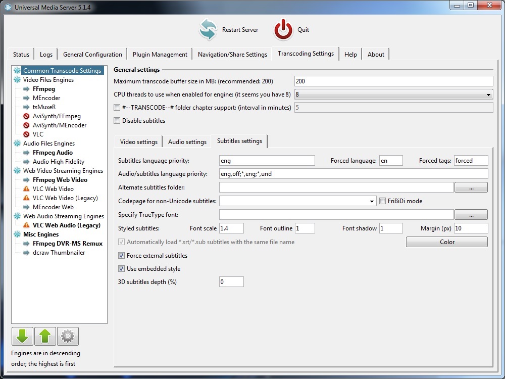

I attached screenshots of my audio/subs settings. Are you saying that to receive the desired effect I need to change the content of the Forced Tags field from "forced" to "Subtitles"?
I tried that but then ran into an entirely new problem. The .mkv that i tried to test with no longer plays the Japanese audio track by default. It played the Japanese audio track by default just last night so I thought it was the change I made but the same thing happened after reverting the change. I tried with another .mkv and the Japanese audio played with the English subs (note: this .mkv does not have a signs:songs sub file). Tried the first .mkv again and the same thing happened, English audio. Attached the trace log so someone smarter than me can tell me what is happening.

You set audio preference to "jpn,eng" but there is also audio/subs preference set which has a precedence so "eng,off;*,eng;*,und" is used.
How to read audio/subs priority? If eng audio is present, play it with disabled subs. For any other language use eng subs. If there is no eng subs, try to load undefined subs (I am sure you can set undefined audio but totally not sure if same way it is possible to set undefined subs).
So in your case audio/subs priority is used and that means english audio if exists and no subs.
Now what no subs really means? It means no subs except forced subs (depending on forced language/tag setttings) or any subs in case "Forced external subtitles" is checked.
In last post I wrote about the way how to override full subs instead of signs/songs without remuxing file and changing order of subtitle tracks (e.g. with MKVToolNix). But this way has side efects on any other files which are not similar to ones you describe. So if you have whole series of similar files, with same descriptions of subtitle tracks, then it will work for them but not with others.
And yes, if you are trying to force second subtitle track instead of first one which is signs/songs, then use "subtitles" string instead of "forced" as "subtitles" is only present in tag/description of second subtitle track which includes full subs.
So if you want to play jpn audio with full eng subs for your specific file(s) you need to add at the beginning to the audio/sub priority this: "jpn,off;" and forced tags change to "subtitle".
This change will force jpn audio and no subs but detected forced language override it so full subs are taken.
This settings is totally wrong but will work for your specific request and your specific file(s).

So I made those changes but it didn't work. Then I found out there was a better renderer config for my TV. I also decided to take a look at that MKVToolNix program (which is great). I found that the Sign:Songs file was marked as the default. Changed the Subtitles file to be the default. Then I was able to get the desired effect with just the Subtitles tag and it didn't affect my other files.
