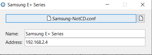

Hi Hoschi, can you tell me how were you able to play from the UMS software to your Samsung WAMs? I have the M7 (WAM750) and I can't play from UMS directly to it; I have to go through the Samsung app, since UMS recognizes it as Samsung E+ Series and that's how far I get:

JFk1811 wrote:Hi Hoschi, can you tell me how were you able to play from the UMS software to your Samsung WAMs? I have the M7 (WAM750) and I can't play from UMS directly to it; I have to go through the Samsung app, since UMS recognizes it as Samsung E+ Series and that's how far I get:
Check http://www.universalmediaserver.com/faq ... erSupport1 and see if you can create an specific profile for it.

Hi Wolfgan,
thanks for your reply. I tried to set up a specific profile and failed, therefore I was wondering how Hoschi managed to set his speakers up.

JFk1811 wrote:Hi Wolfgan,
Post the relevant info from the logs you got following the FAQ and your try for the custom profile and maybe the community can help (without actually having that hardware to test)

Hi, sorry have been in holidays.
Yes I created a custom profile for the device.....
The most important point was, set everythingto wav and chunked transfer to false
