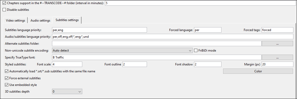

Hello
I just installed Universal Media Server and my MiraScreen device detected and worked fine but the problem is I want to load Persian subtitles while the server always load english one.
I have changed settings but there is no Save button so I suppose it's autosave in this version, isn't it?
In fact not only subtitle priority but also other settings such as font and size not working too.
Did I forget anything?
Here is a screenshot of subtitle settings:

Are you using .srt or ass subs? Does that device support either format? I'm going to assume no for the following.
First try getting rid of *,eng in the audio/subtitles line. Or you can change it to *,per. If that doesn't work, try getting rid of everything in that line.
In the FFmpeg subsection, check "Use font settings..." (I think that's what it's called. UMS is not running right now). That should activate fontconfig to use your font/size settings.

You should follow the Madoka advice for your subtitles styling.
Though you should deselect the "Use embedded style" option in the "Subtitles settings" sub tab.

Madoka wrote:Are you using .srt or ass subs? Does that device support either format? I'm going to assume no for the following.
Sorry for late reply cause I got no notification or email regarding any reply to my thread.
I'm using srt subs and checking "Use font settings (size, color ...)" worked for me!
Thank you buddy. :D

Sami32 wrote:Hello moeinbiz,

Thank you Sami
The problem solved fortunately but I will read the wiki for cause I need some other option too.
well noted for embedded style.
