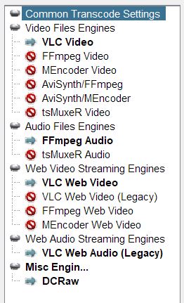

Then, inside the UMS GUI, I went into the transcoding settings and did this:
Also, within the VLC Video and VLC Web Video settings I added a check box next to "Enable Experimental Codecs".
