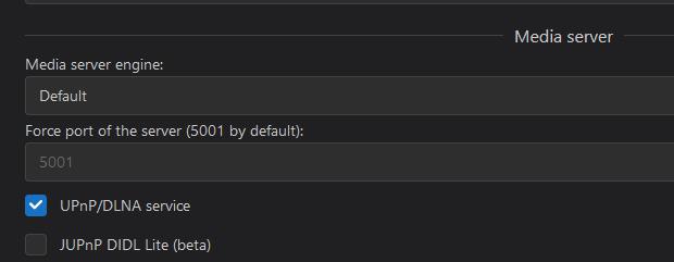

Re: "Data type is not supported" (800288BF) error on PS3
I had a quick look and didn't see anything out of the ordinary.
That avi file should play as it is being streamed, unless has been encoded in a different way. Was this file playing normally on a previous version?
There is a setting I have not seen before in your UMS.conf file and I believe it is related to a switch in one of the networking dependencies.
upnp_jupnp_didl = true
Looking in the web settings it is "JUPnP DIDL Lite (beta)" and as this is a beta it could be buggy.
Clipboard Image.jpg (12.81 KiB) Viewed 15161 times
Try and turn this off and see if this fixes it.
KONTROLMASTER
Posts: 52
Joined: Wed Aug 06, 2014 6:54 am
Location: Rusteam
Contact:
Post by KONTROLMASTER »
Turned off, no, if only it was this setting for now.... Seems to be very strange.
