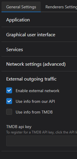

You can turn the metadata off if you do not want it, This is in general settings.

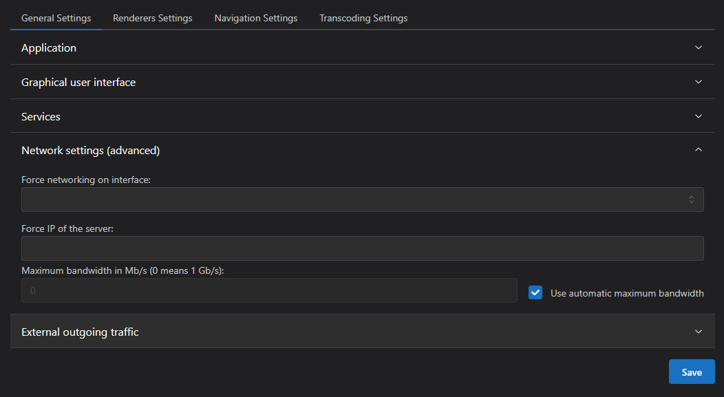

Transcoding should take in to account of your network speed to the device so will automatically pick the best bitrate for your connection.
You do need to have "Use automatic maximum bandwidth" enabled. This will run a speed test on that connection when UMS detects that device.
It only runs once when the renderer is detected so If you are out and about where the speed could change then this may not be good enough for you.
In this case you could manually set "Maximum bandwidth in Mb/s" to the lowest you expect to have.
Screenshot 2025-10-19 004108.png (24.17 KiB) Viewed 39318 times
You could even do this in the renderer's conf file so it only affects that device and not any other renderers.

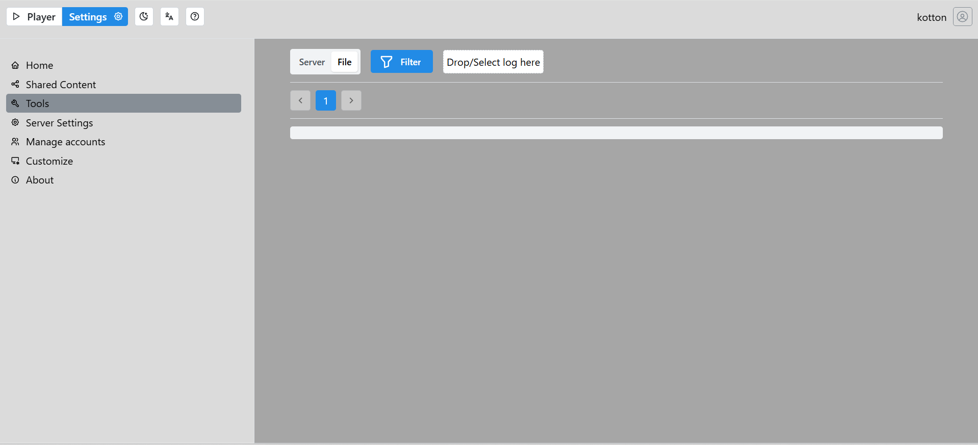

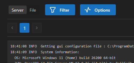

Press the server/file button to get the logs. Easier to see in dark mode.
Screenshot 2025-10-19 024024.png (11.71 KiB) Viewed 39301 times
The instructions for making logs are in the red section above.
There will be an option to restart in trace mode then you and attempt to play then pack the logs to post.

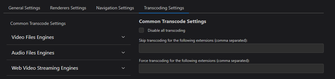

If you only intend to use it on the one device remotely you can set it up to force transcode. (I'm not sure but I think * for everything works)
Screenshot 2025-10-19 031751.png (18.28 KiB) Viewed 39301 times
I would not suggest you use this if you want to play on other devices as this is a global setting so effects everything.

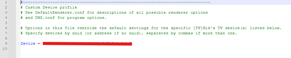

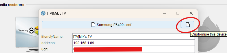

If you know that you are running VLC on your phone you can make a custom conf with its unique ID so that it will always transcode and override the existing vlc.conf
This option is not on the webUI but if you use the old java GUI you can create an empty conf with the devices details.
Screenshot 2025-10-19 025055.png (34.22 KiB) Viewed 39301 times
Which will open your text editor to allow you to edit it.
Screenshot 2025-10-19 025937.png (14.43 KiB) Viewed 39301 times
You can then set this option and list all the extensions to transcode
