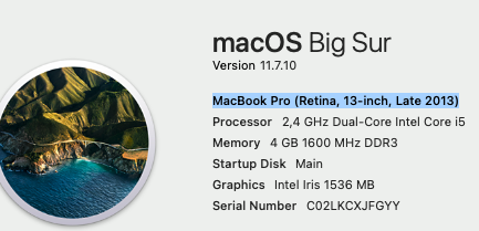

AS of 19 DEC. 2025. I have problems with Vers. 14 and 15:
With 15Ii can not scan a database over 2 GB
With 14 the server stops working after an undetermined time Restarting the sever brings it back.

I have not had the time to go in depth in the logs but I don't see any errors.
I still think it might just be there is not enough memory available for the size of your media collection. There are IDs reaching up to 20000 for some directories.
There are not any other indications it could be this but the logs are much larger than there should be.
It does show it has 1.7GB free memory when these logs started and it was running for 13h when before it stopped a lot sooner when there was less memory free at the start.
It could also be getting further each time as it does not need to rescan those files it had previously scanned before which is memory and CPU intensive to do all at once.
Could you try only sharing one or two small folders and see how long UMS runs for? You can then add larger and larger folders to see if you can find the limit.
I think another factor is the conf that is being used for your TV.
It is using LG-LA6200.conf as a default as there is probably not a more suitable one and that is just saying to stream everything.
One thing is missing is what subtitles are supported so I do see a lot of messages saying each embedded sub in a video cannot be streamed which may increase the database size.
I'm not entirely sure of the TV you are using. I think the model number is PF1500-NA but this appears to be a projector, is this correct?
I found a manual (p64) for it that lists the supported formats so I could make a better conf for it.
