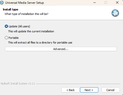

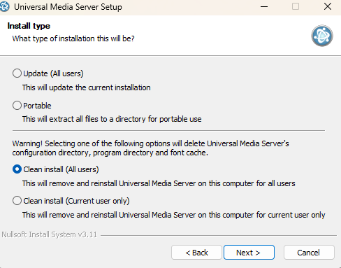

Looking at your UMS.conf I can see it is very old as it has settings that have been removed, renamed, or moved to a different conf many versions ago.
I suggest doing a clean install to eliminate problems caused by this. You can chose this in the advanced section when installing. You should backup C:\ProgramData\UMS first just in case you want to restore your SHARED.conf or the database if you want to keep your played status.

doing a clean install too (never noticed that option^^)

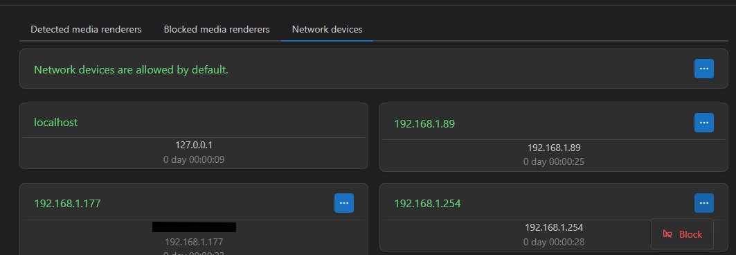

You could block 192.168.0.254 in UMS so it will be ignored.

If you have no interest in this then just block it in UMS, however this may also any traffic though it so if nothing is detected when the PS4 is on then unblock it again. Your PS4 problems could be due to network speed to it but in your previous logs it had a speed of 54mb/s which should be fast enough but will need to see trace logs of the PS4 playing video to get any more info.
