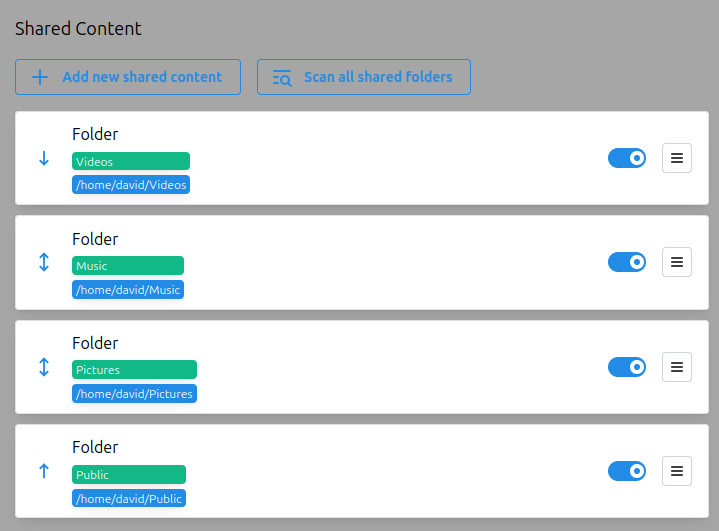

boss wrote: ↑Tue Jun 30, 2026 10:07 am I did a fresh install to check and it did not add them for me.
What OS are you installing on? I just did a fresh install on Mint 22.3 and it automatically added Videos, Music, Pictures and Public folders from ~/
In every version of UMS that I have tried during this testing some folders have been automatically added. In newer versions it is the folders listed above and in older versions it included the home directory (~/) and the UMS install directory (in my case /opt/ums-x.y.z).
How do I get UMS to not do that?

PS: Just turn of the /home/david/videos pictures music public folders for now.
