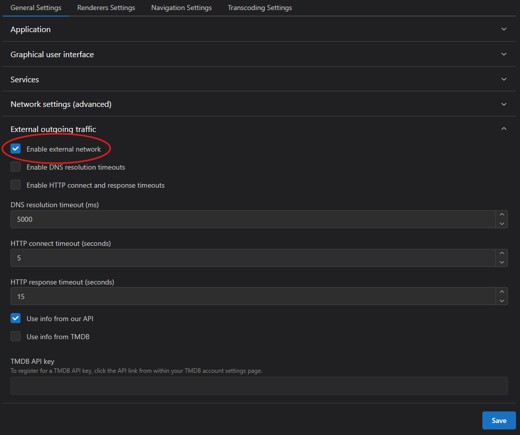

You can test by disabling external networking in the options to prevent any access outside your network and if it is still a freezing it is a local problem.
Screenshot 2026-07-09 114703.png (41.9 KiB) Viewed 9666 times
