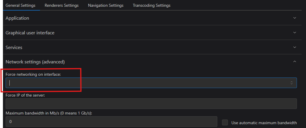

If UMS is choosing the wrong network interface then you can force it to use the physical one in the settings. It should usually be ignoring the virtual VPN interface.
Screenshot 2025-08-27 052831.png (21.9 KiB) Viewed 76843 times
UMS is meant for serving the local network but it can be used outside if you know what you are doing, this might help with one method of doing it and I remember other guides somewhere on the forum but can't find them at the minute.

mik_s wrote: ↑Wed Aug 27, 2025 4:36 pm I'm not familiar with Tailscale but a quick search shows it is a VPN.
Problem with commercial VPNs is if you do not control the source and destination then these will not work with UMS as it is connecting to someone else's network.
UMS can sometimes select the active network interface which can be the VPN so it cannot transmit on your local network at the same time.
I don't know if Tailscale gives you control other both sides though.
I don't know anything about VPNs or how to configure them but if set up properly your remote computer will appear on your network as a local machine then this will be transparent to UMS and should work as normal.
Setting the Force IP of Server to the local IP of the machine it is running on fixed it. The server shows up on my PS3 again while the web server works both on the local IP and the tailscale IP.
