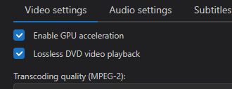

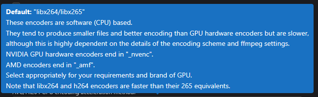

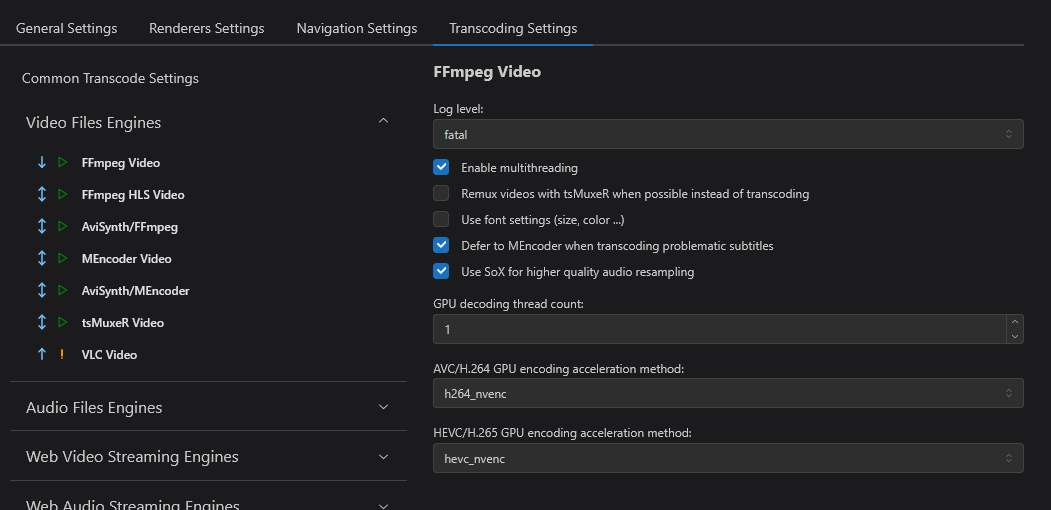

If you have a decent graphics card enable GPU acceleration, HEVC/H.265 and AVC/H.264 GPU encoding acceleration methods to use the hardware encoder.

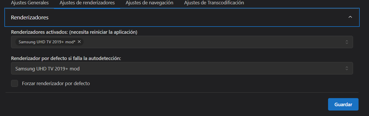

Still not working with new profiles. I did this to force the app to use them
Here are the logs.
Here are the logs.

Enabling the GPU will speed it up too.

If your TV supports it then this conf will enable it.
I would need to see examples of other videos that you are using "no transcoding" with as those should not be automatically transcoding if the TV can play them.
You don't need to change the default renderer, it should automatically detect it.

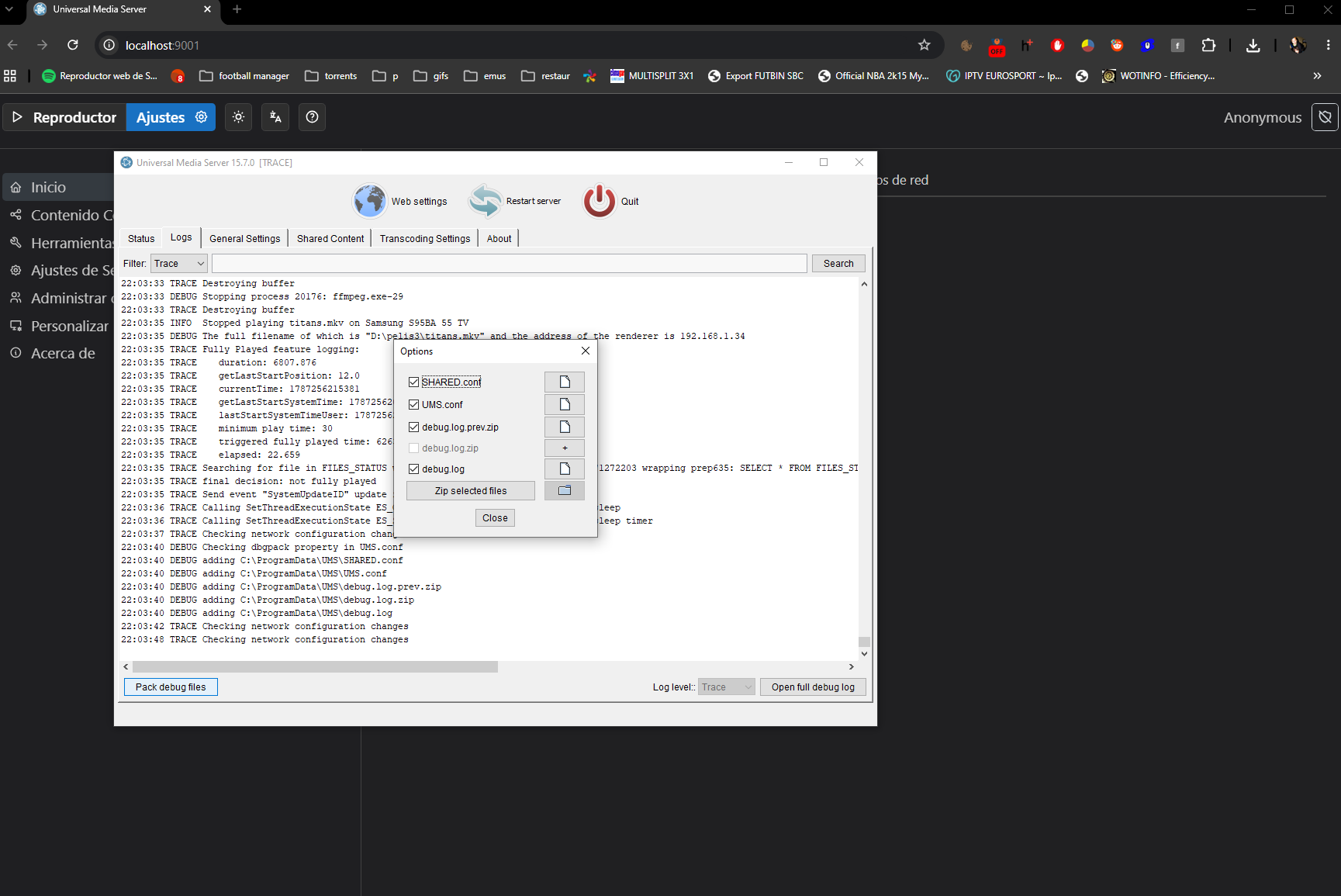

Make sure when packing logs the renderer conf is selected too as it confirms it is being used.

I checked the packing logs box on v15.8.0 and it does not give the option to attach the renderer conf like it should. I'll report this as it should be including them.
