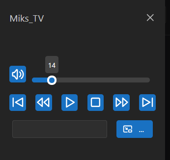

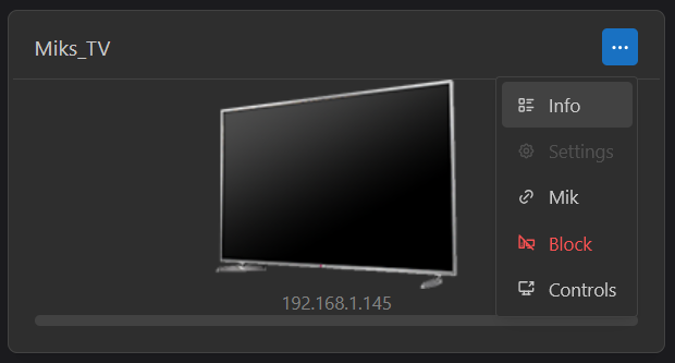

You can do this by clicking on the renderer icon. In the web interface there click the blue [...] button and then controls which opens a side bar.
Screenshot 2026-10-17 110300.png (41.1 KiB) Viewed 214 times
Screenshot 2026-10-17 110323.png (10.29 KiB) Viewed 214 times

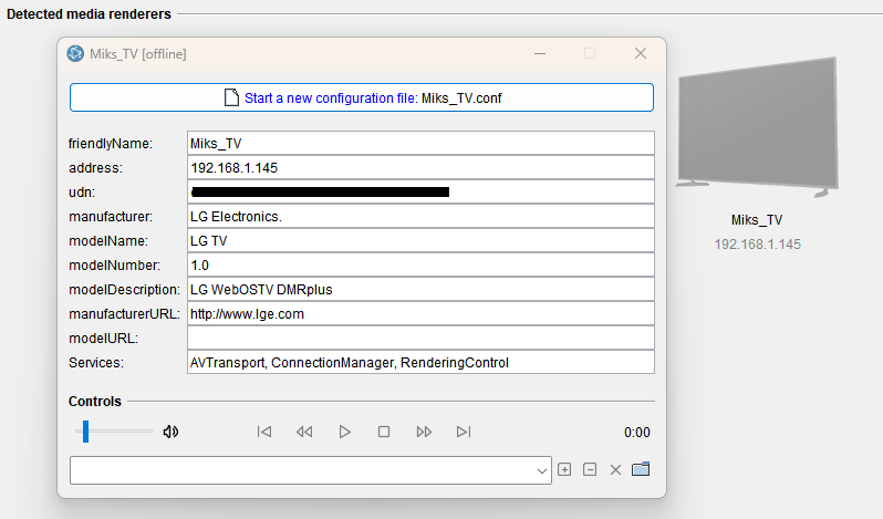

In the old GUI it shows controls at the bottom of the renderer info.
Screenshot 2026-10-17 111301.png (37.09 KiB) Viewed 214 times
It may not work if your TV's settings blocks these control signals.
I don't use this but just tried and would not work. In the logs was saying the TV sent the message "Error: Action not authorized".
I think it is probably because I have never connected to the internet or accepted the T&Cs but could be something else.

mik_s wrote: ↑Sat Oct 17, 2026 10:32 pm You can do this ...
Thx a lot for the hint. I tested it directly. It's running but not for every video on my disk. I think in the old version it worked better.

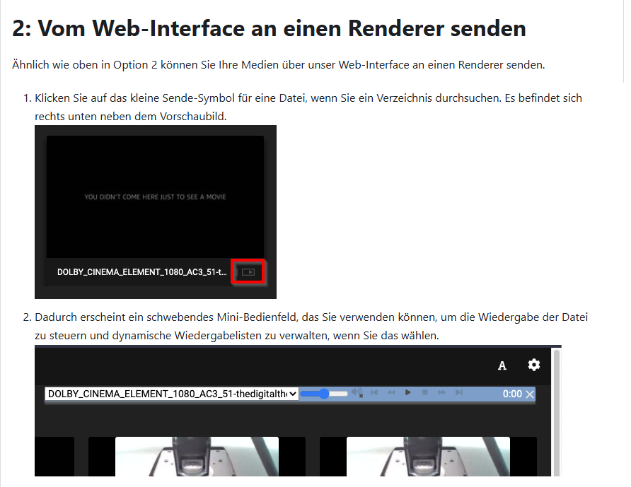

I used to use it differently. This is still visible in the knowledge base by pressing the play symbol in the red square.
Is this option still available, or does it need to be activated?
Re: Send video to a device
I think that was changed into what I showed before as that looks like the old webUI.
That knowledge base probably needs updating.
